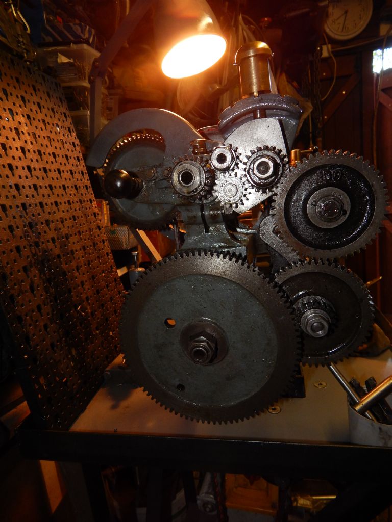

Made new bushes to space the gears .
Spacers fitted and added a 4mm roll pin to the reverse tumbler. I also swapped the knurled nuts for plain nuts on the tumbler. The tumber shown in nutral unengaged position in the centre.
