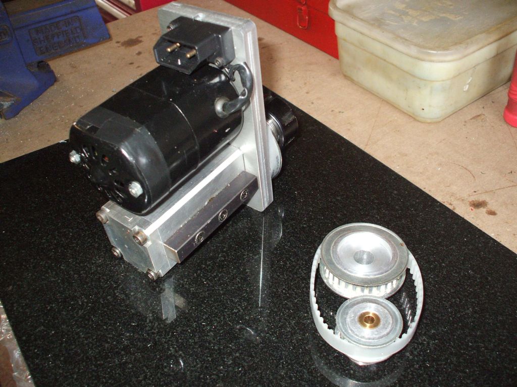

Toolpost spindle v3 rear view
By using pulleys of differing diameters and therefore tooth counts along with belts of slightly different lengths, I can swap the pulley pairs around (not the largest/smallest pair as shown mounted in the photograph) to give a possible combination of speeds. The motor comes with a crude foot-operated speed control as well for further refinement in that department.
