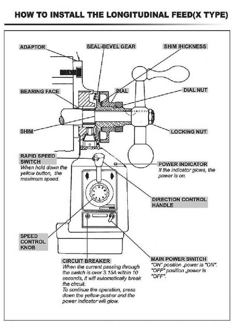

align power feed instruction manual page 3
Extract from the installation manual shows the general arrangement of the power feed as installed.
