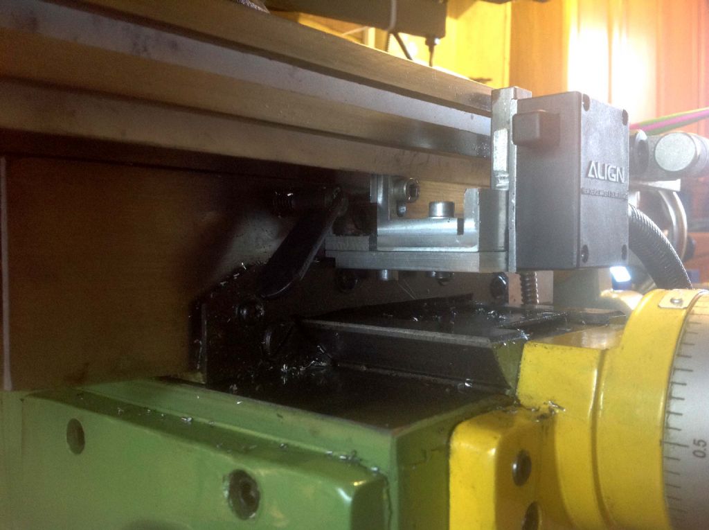

read head mounting and limit switch
Close-up of the read head mount, combining both the power feed limit switch and travel limit stops. There is a certain amount of interference with the Z-axis travel at its upper limit, but nothing that cannot be overcome by juggling the quill downfeed and and Z-axis movement.
