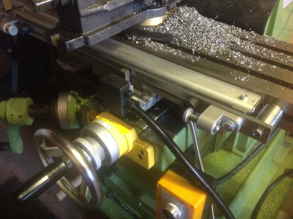

x-axis scale 1
All finished - except for radiusing the ends of the travel limit mounting strip. I had to modify the power feed switch so that the cable exits to the righthand side instead of underneath, in order to prevent it fouling the Y-axis handle when fully extended outwards. Yes, I did eventually vacuum up the swarf - of which there was plenty!
