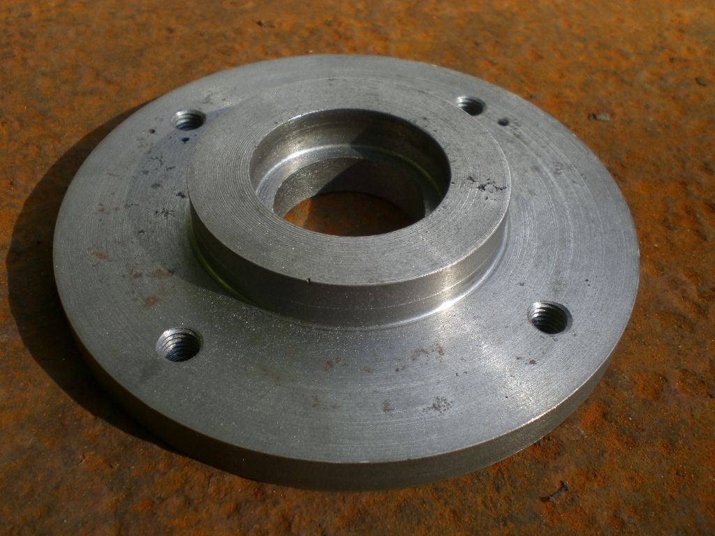

The position of four holes that were drilled in the brake disc hub were trasnfered to the top of the roller and these were drilled and tapped for 8mm set screws
