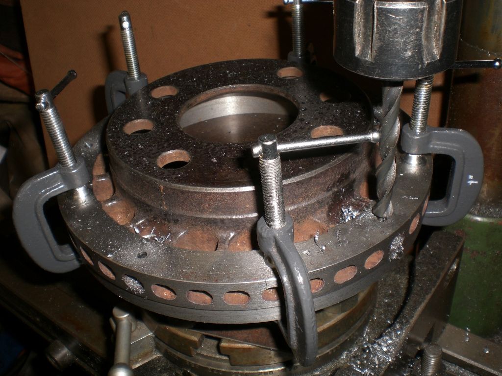

After spotting five equispaced points with the centre drill, they were piloted with a small drill and then drilled out at 8mm. Two small holes were also drill at allmost 180 degrees for two small roll pins which will identify the rotational relationship of the two parts
