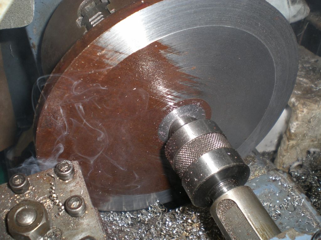

The slice was gripped in a four jaw on the pre machined face and centred, it was then bored and faced a little in the centre portion to enable the use of a revolving centre to help facing accross the whole surface witout it been pulled out by heavy cutting.
