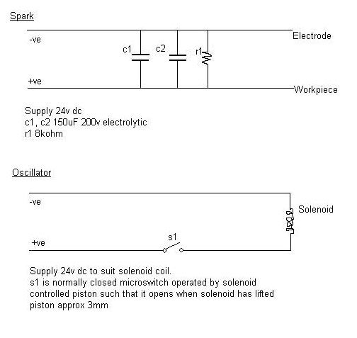

Circuit diagram
Apart from your chosen method of providing the voltage and current needed that really is it.
