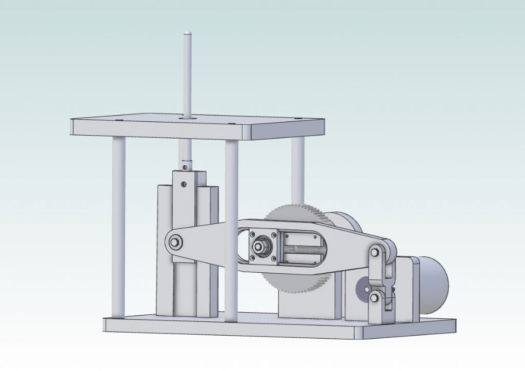

Die filer design
Following up on a query on the forum, I put together this design for a die filer utilising a modified bull wheel and ram combination from a shaper. It provides adjustable stroke as well as slow downward travel and fast return stroke.
