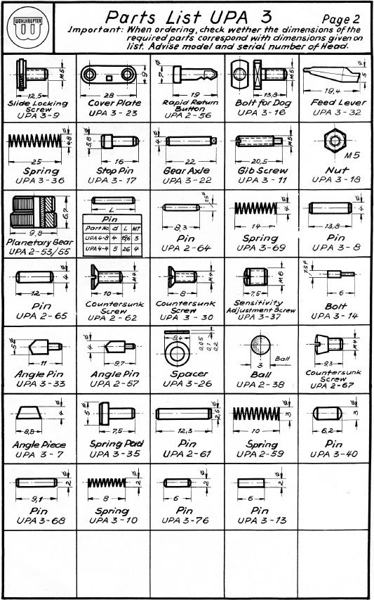

upa3 parts list_2
Wohlhaupter parts list page 2.
Uploaded by John Hinkley on 14/04/2021 19:33:54
