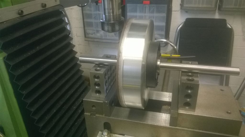

balancing grinding wheel
I ordered a couple of wheel hubs for my Warco surface grinder on which to mount two resin-bonded diamond wheels. Then realised I needed to at least check them for balance. The grinder is supplied with a balancing shaft so I set the wheels up on the mill vice with a pair of 1-2-3 blocks to obtain clearance. Luckily the mill is level! Worked quite well, I'm pleased to say.
