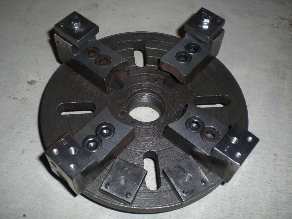

The jaws were then machined to hold a blank backplate snugly and were drilled and taped for clamp plates, and grub screws were used in each jaw to nip the edge of the backplate blank
