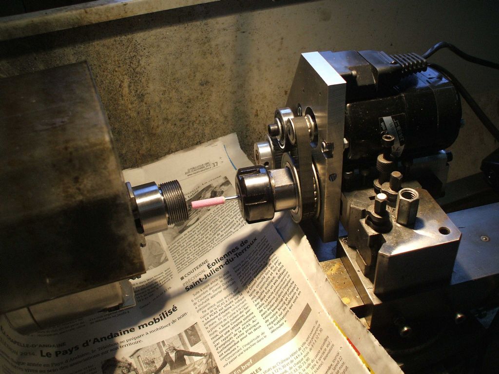

Preparing to grind the collet bore.
Used my angle-setting gauge to align the toolpost grinder on the compound to 8° set-over, ready for grinding the collet holder.
