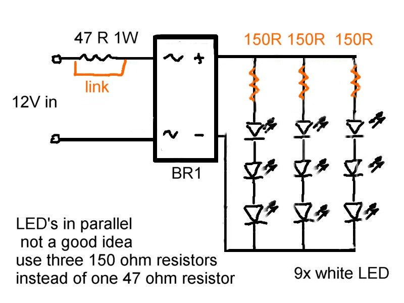

Uploaded by john swift 1 on 06/10/2014 13:18:19
