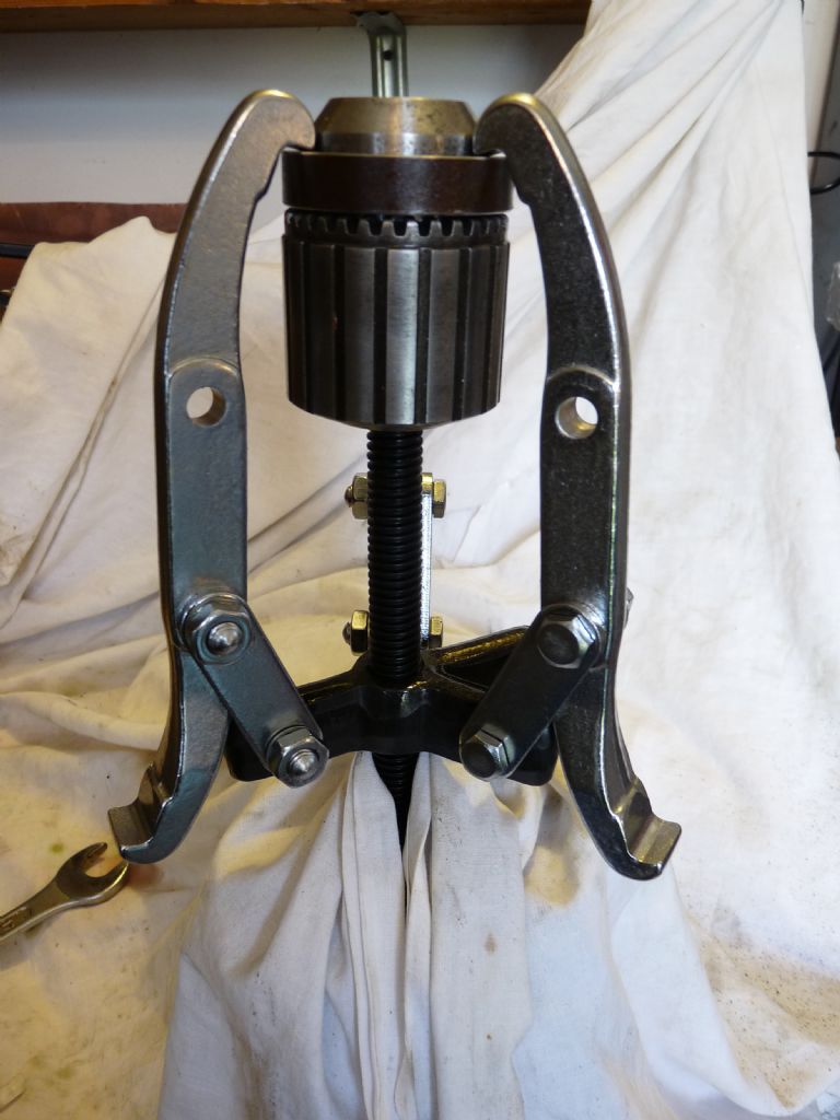

Pulling the sleeve back on with a collar I had to make to protect the gear teeth. The main problem I had was getting the puller jaws set for a straight pull. The puller was held in the vice and I turned the puller to get a good feel of the progress.
