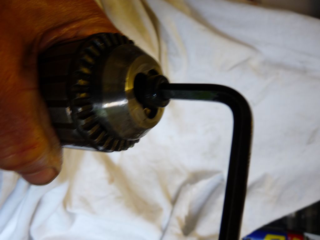

To get it back together again, I needed to remove the arbour. I drilled a 6.9mm hole and tapped it 8mm*1.25mm to extract the arbour.
