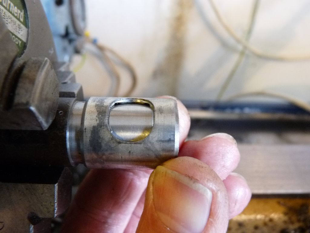

Put plug gauge back into lathe, original position was pop marked at jaw 1 + tighten at name plate. True to .01mm in lathe, near enough for this test. Load bearing onto plug gauge, slight smear of iso32 oil only. No disernable play.
