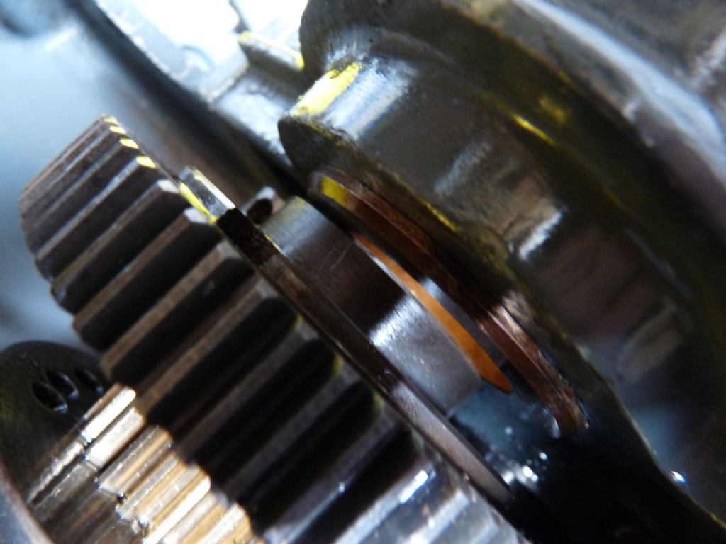

Mark the position of the keyway on the bullwheel boss. it helps in alignment. You may need to back out the bearings with the C-nuts using the C-spanner to insert the rear spacer, pulley and backgear, before carefully inserting the spindle and don't decapitate the wick. .
