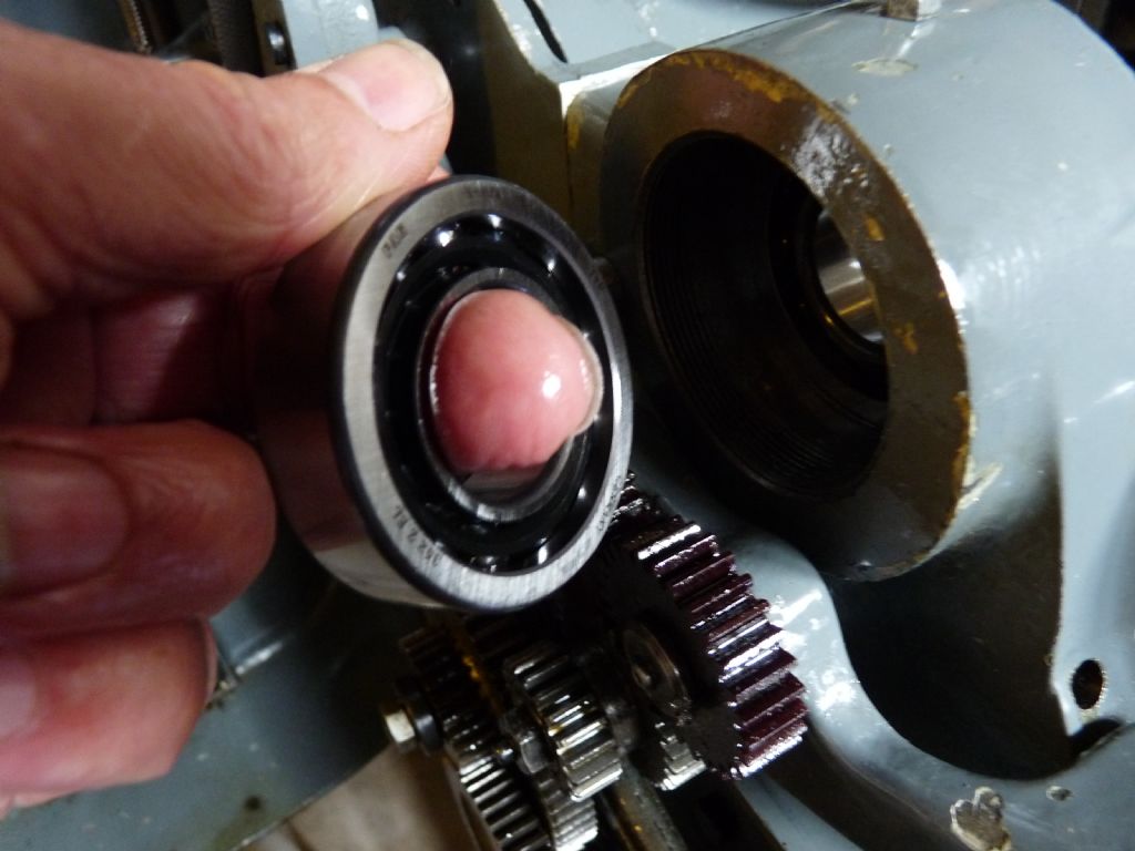

Make sure the bearing is the right way round. Pull this bearing in from the tumbler side, until it meets the spacer and in-board bearing. Then screw in the out-board C-ring until it touches the bearing.
