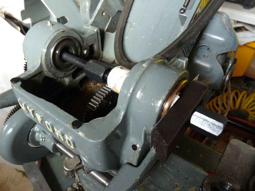

Mill clamps used to extract, very little force is required. Note the aluminium protector between the clamp and face of cone + a thick roll of paper in the cone itself. Pulled both bearings out together towards the cone bearing. You may need to reset the stud to maintain enough thread to complete the extraction.
