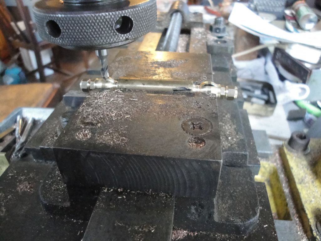

a start made on the globe valves on top of the boiler for the injector steam valves. 'globe' shape (3/8" dia) formed with a large radius tool and clockmakers gravel. spigot recesses about to be milled in the dore westbury.
