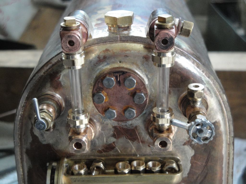

a bit more progress on the water gauges. 3/16" dia glass and 7/32" x 40 tpi caps on top, and 9/32" x 32 tpi spigots top and bottom for the 5/16" AF hex gland nuts, only the top spigots silver soldered in position so far
