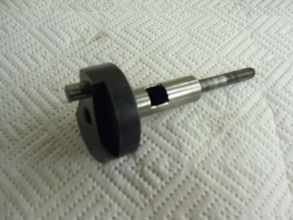

Crankshaft.
A hardened 1/2 inch diameter silver steel shaft is pressed into the heavy counter balanced mild steel web. The crank pin is made from a shortened 1/4 inch needle bearing roller. The hollow crank is used as a rotary induction valve.
