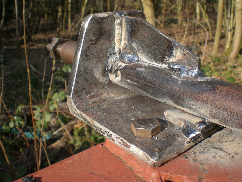

Close up of one end, showing gusset welded in. Note the hole in the tube where the stub enters the tube. It is one of two this end and there are two at the other end and these are for plug welds. A packing piece has been added between the angle and the tube by the bolts to tie the angle and tube together.
