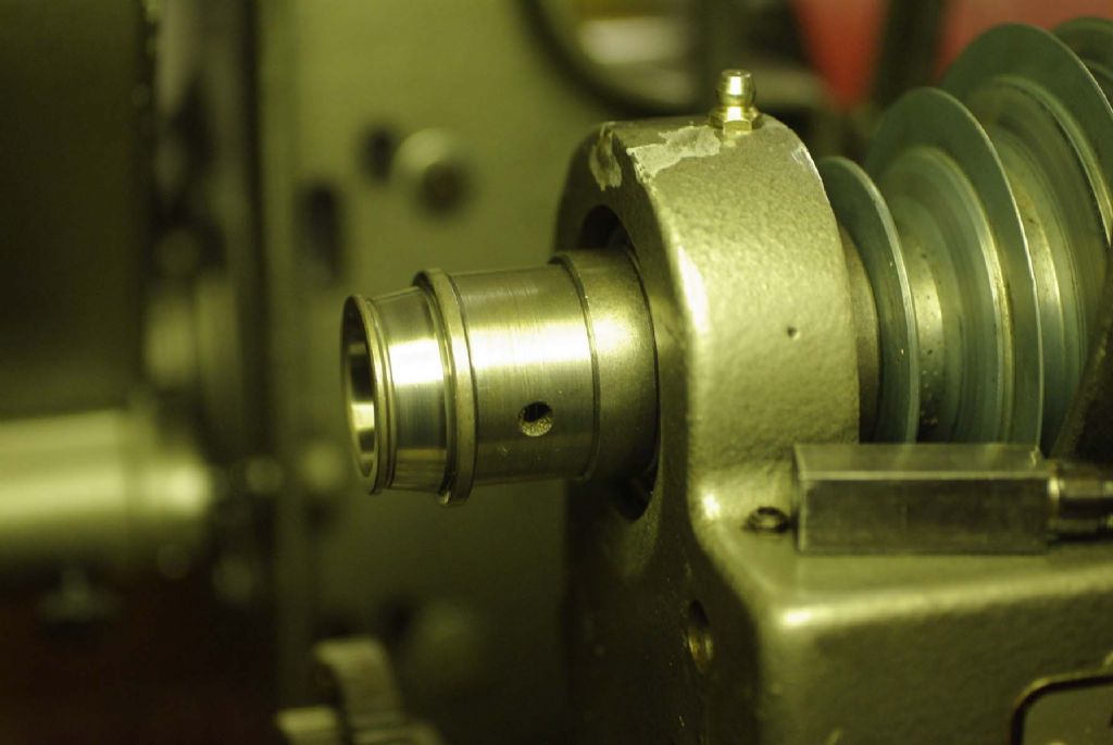

Additional bushings were added as the outer bearing seated. This prevented the nut and plate on the threaded rod from jamming up on the end of the spindle.
