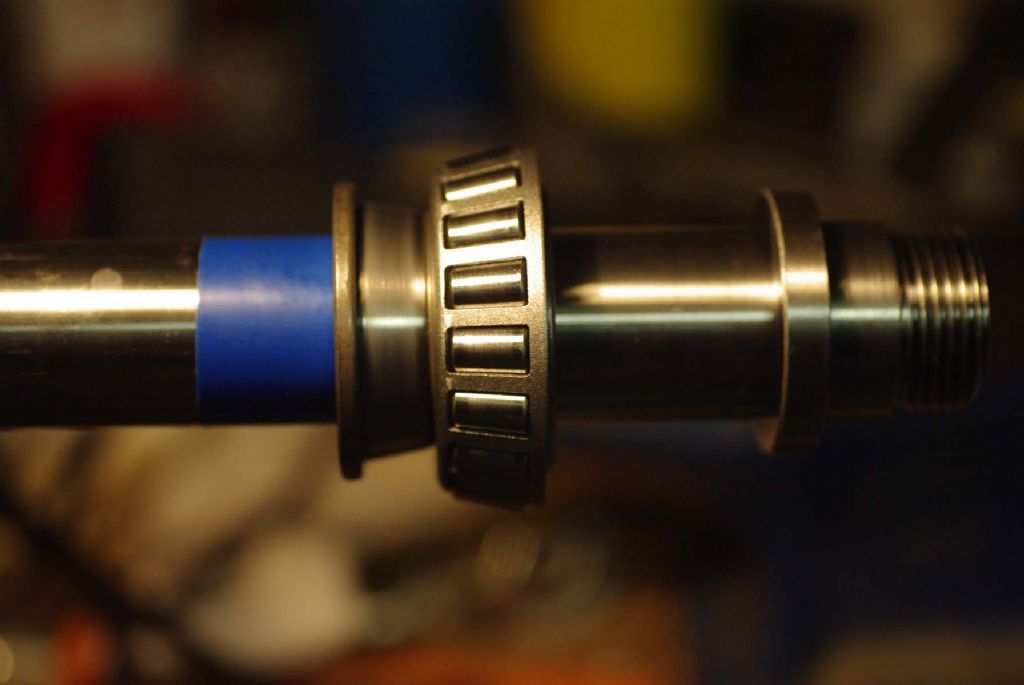

Blue Mylar tape was utilized to prevent scoring the spindle. The cone from the old inner bearing was used to start the new heated bearing onto its seat. The cone needed to be removed just before it started to contact the bearing seat. Otherwise it would have jammed onto the seat.
