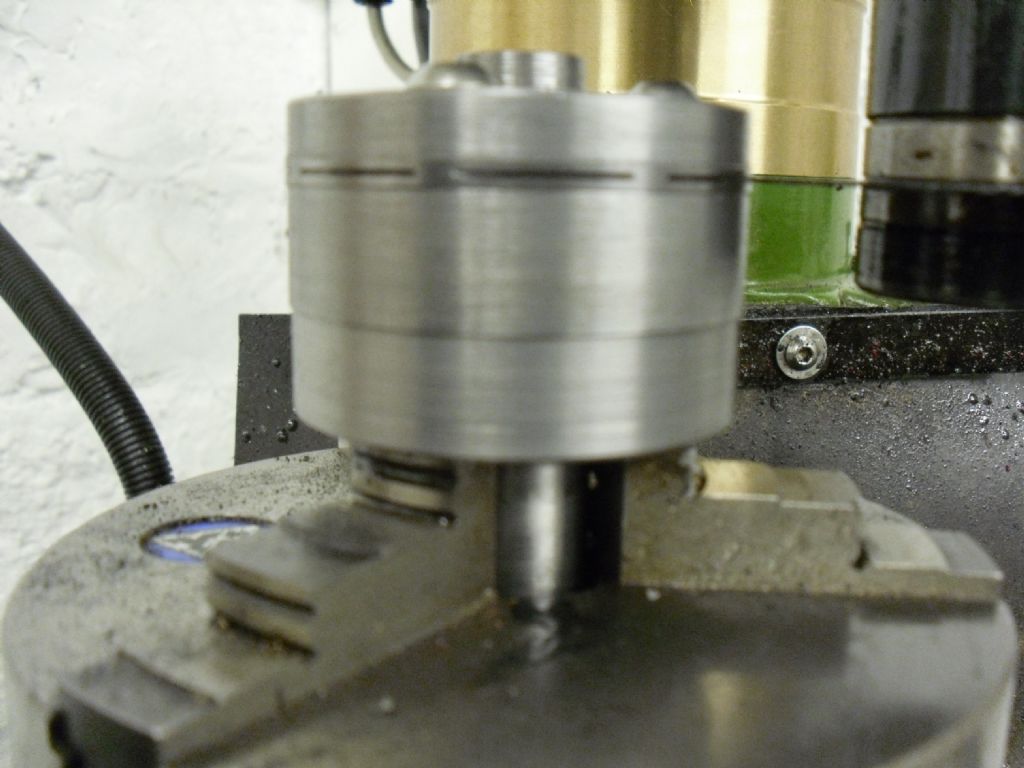

Oil control rings.
This fixture was first used in the mill to cut the oil slots, then transfered to the lathe to cut the shallow central groove to form the oil scaper ring.
