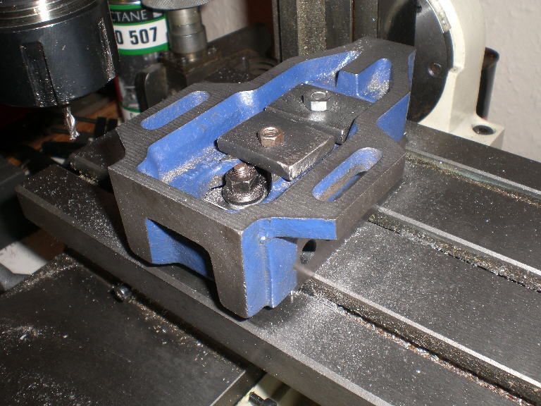

The vice was then set up on a 3-2-1 block and the base was milled flat. It was found to be quite unflat on the original machining and not particulary parllel to the bed.
