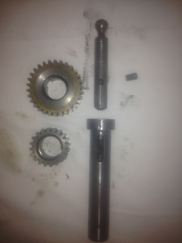

Back gear ratio selector
This is used to select one of two backgears or neutral. The grub screw in the selector pins engages with one or none of the two gears
