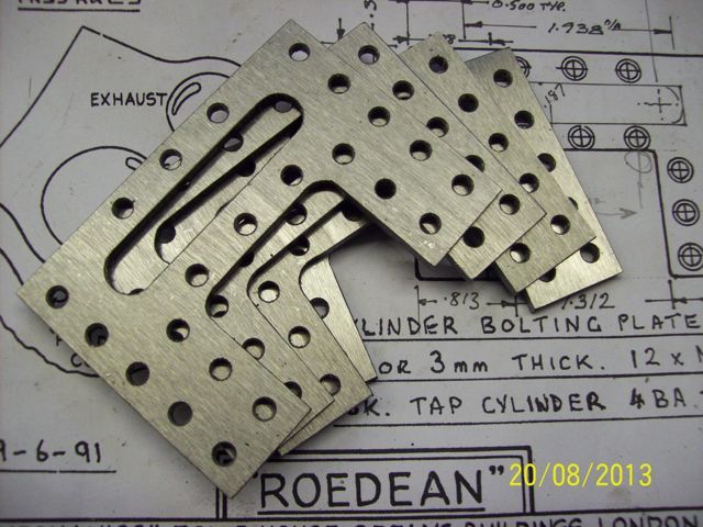

The bolting plates
Made in 1/8'" gauge plate, the bolt holes are drilled to the O/D of a 4BA bolt, rather than no. 27 drill
