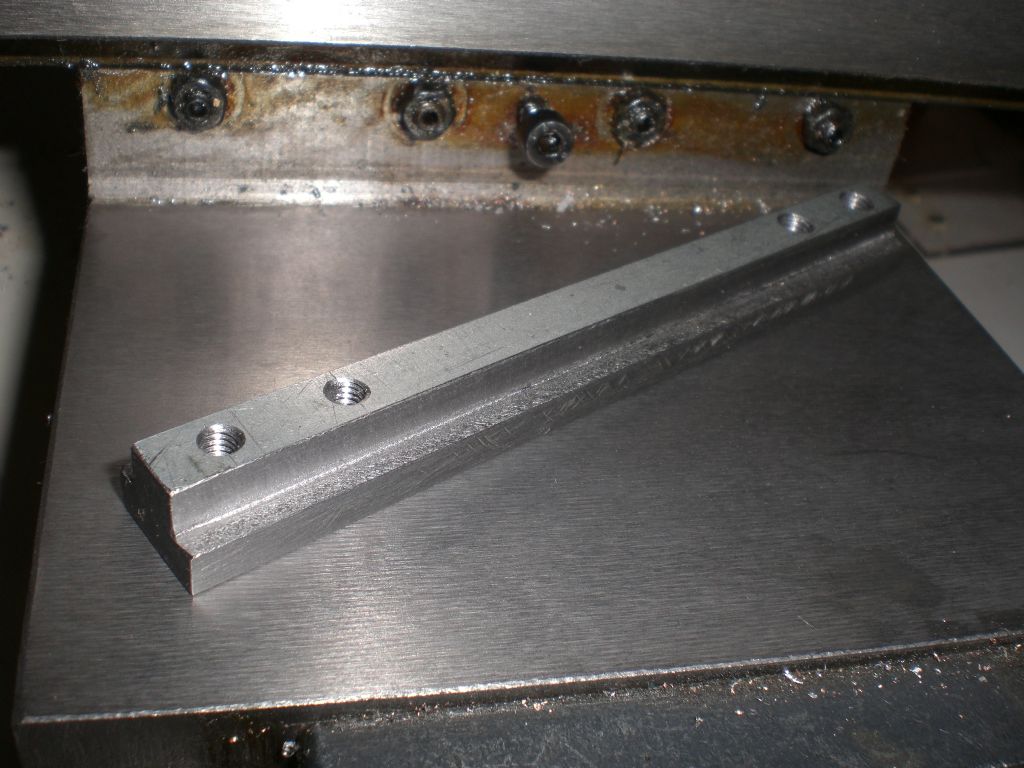

T Nuts for my Mini Mill
Milled a short length of 10 X 16mm keysteel and drilled and tapped two holes 4mm one end and 5mm the other. Just need to be cut into four T nuts, leaving a blank spare bit for another day.
