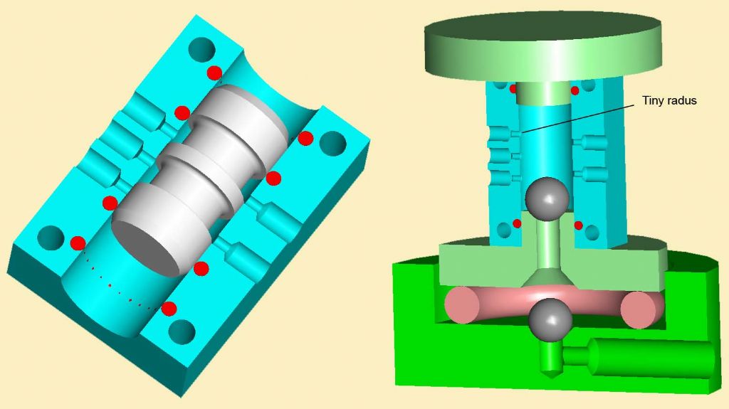

Schematics of the valve body and the improvised pump
On the left is a sectioned view showing the valve body, and the sliding PTFE spool. O rings provided the working seals, while the end caps have been removed for clarity. In the RH view, you can see how the pumping action was achieved. The large O ring at the bottom provided both a pressure seal, and the method of returning the action.
