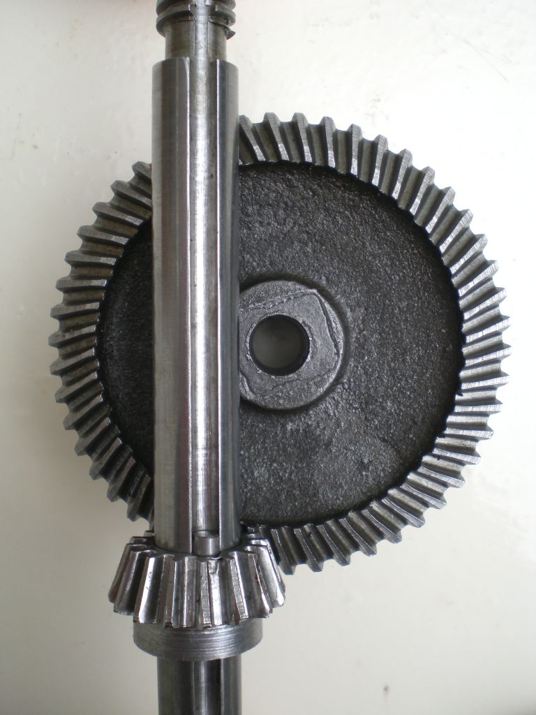

Crown Wheel, Bevel Gear and Drilling Spindle
This is the relationship between the crown wheel the bevel gear and the drilling spindle when installed in the gearbox. As can be seen, the crown wheel spindle has to pass behind the drilling spindle, therefore the teeth cut on the crown wheel are not cut square to the centre.
