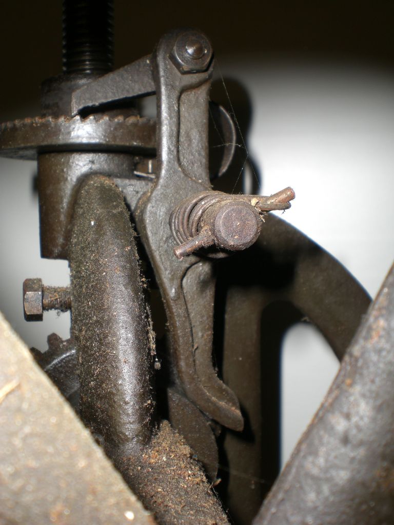

Lever and Cam 1
This is the lever that operates the pawl by the cam on the operating wheel. The screw in the left of the frame can be adjusted onto the lever to limit it's travel and shorten the feed on the drill bit
