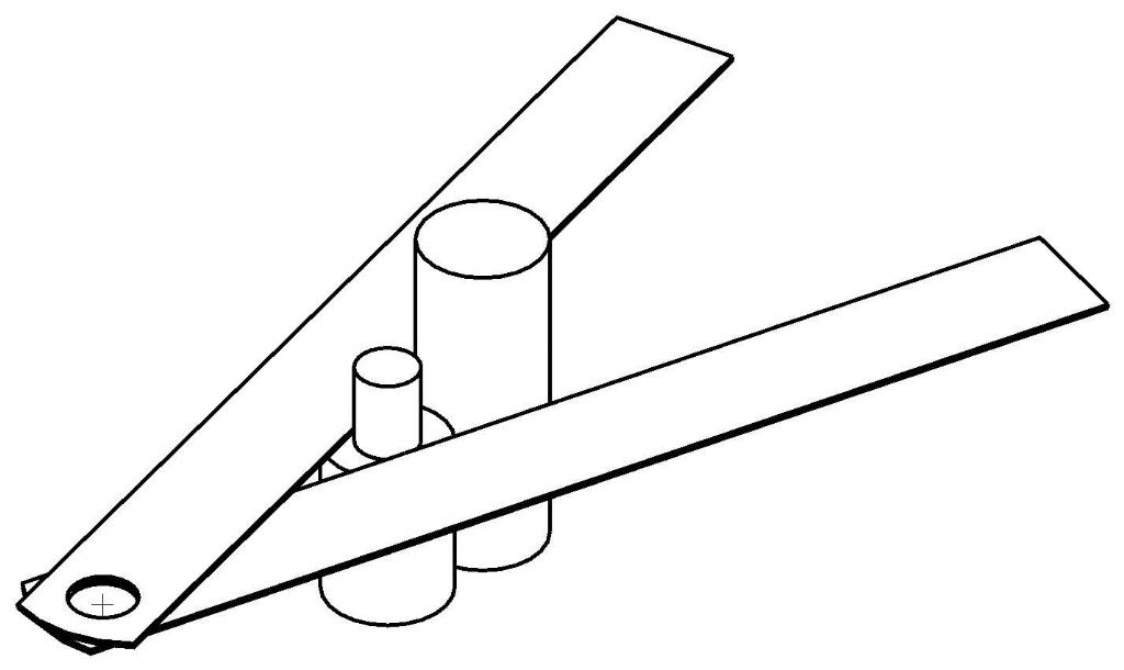

29 degrees
A simple method for setting two steel rules to a particular angle. In this case 29 degrees. Refer to Graham Meek's thread "Suggestions please"
