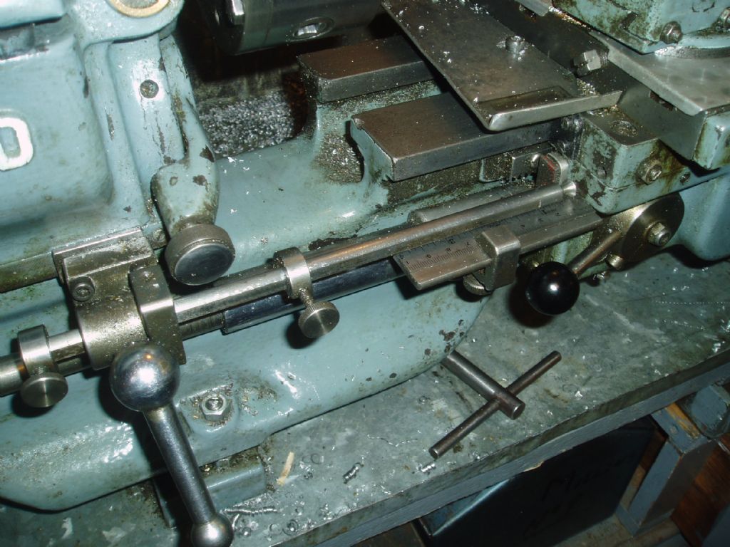

stop for super 7
Adj stop after facing job slide back lock at dim reqd turn to step slips can be used as well
