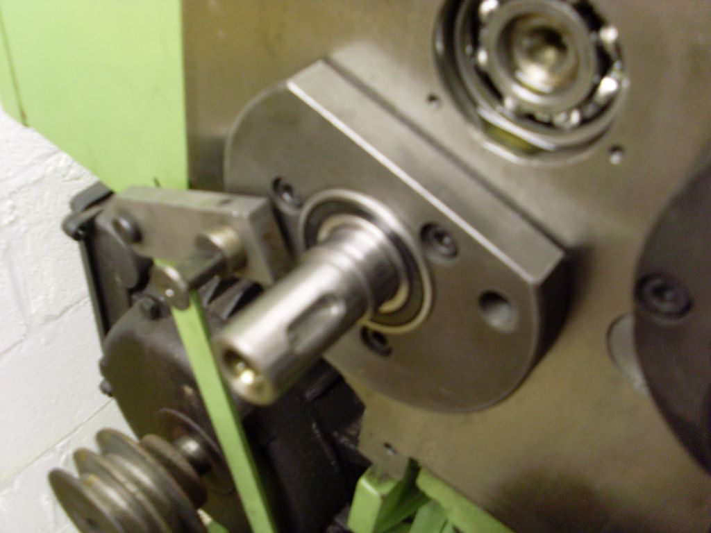

1330 lathe headstock extra bearing.
The cover plate refitted to the lathe. The additional bearing is much closer to the drive pulley which will reduce the strain on the input shaft bearings inside the headstock.
