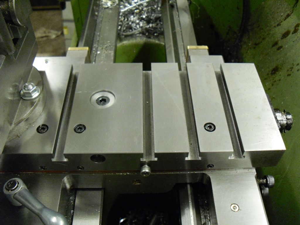

Must have a tee slotted cross slide.
This tee slotted cross slide was added recently. It is in fact a Myford 280 item bought several years ago from a used machine tool dealer. It was unused and i suspect it was a factory rejected item as the tee slots were not machined correctly, the slots were not central to the tee section, making it imposible to use Myford tee nuts. Several hours work remachining and modifying other areas on it and it fits and works a treat.
