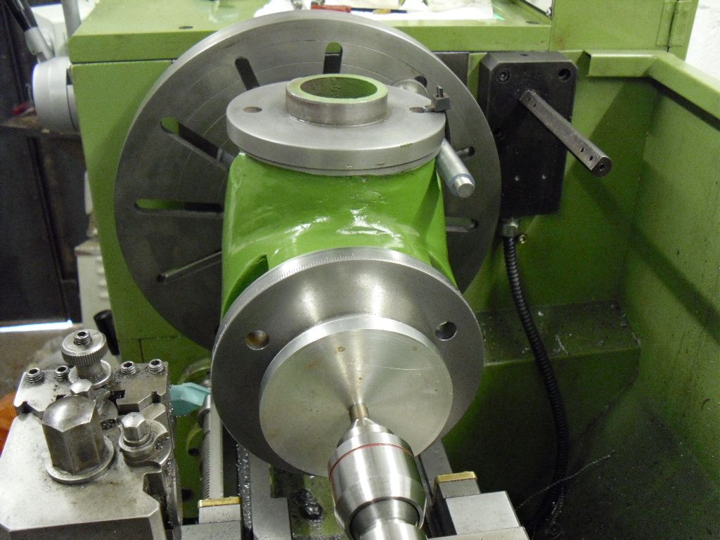

Turret mounting.
The top of the turret casting has been carefuly centre drilled and is rotated between centres driven by a peg off the faceplate. A tie rap secures the drive peg to one of the flanges mounting holes. This set up is for engraving the base flange.
