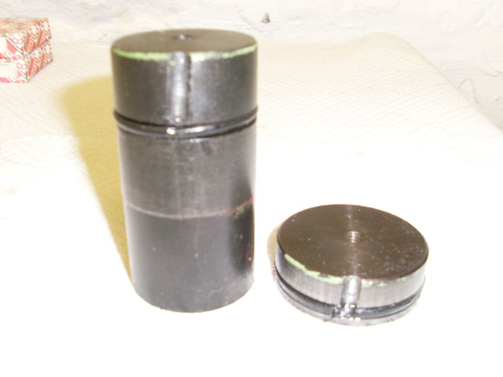

Headstock plugs.
These plugs also locate and secure the gear shafts in position. The factory hand drilled grubscrew holes on the joint line are off square and drilled far too deep, ploughing right into the O rings and their grooves. These were scrapped and new Alluminium flanged plugs were made, these also have a groove fitted with an O ring seal.
