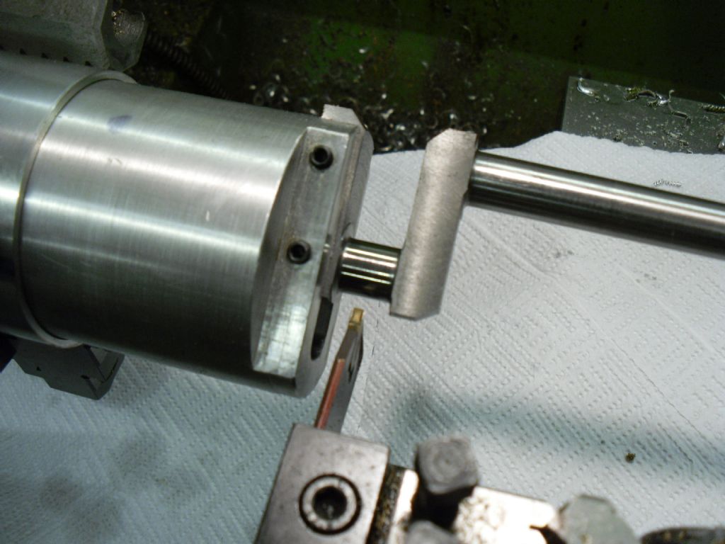

Big end.
A replacable tip parting tool is used to machine the big end journal. The two corners of the carbide cutting tip have been rounded off with a diamond file to ensure a radius is left where the journal blends into the crank webs.
