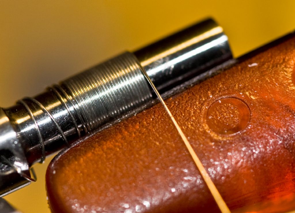

One of my early set-ups showing how I held the close-coiled wire in place with a tooth-brush handle. However, I couldn't control the uncoiling until I hit upon the idea of gluing the wire to the mandrel, and then using a solvent to slowly release the wire.
