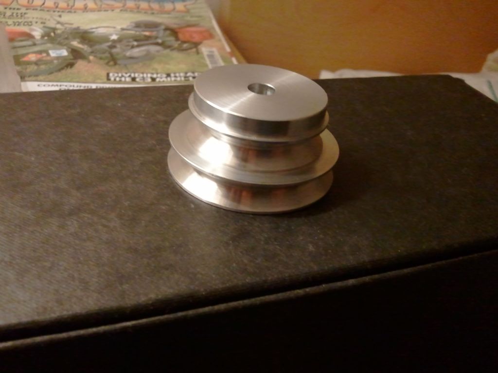

The completed pulley.
the 'v' grooves are 80° inclusive, this angle was duplicated from the pre-made drill. When reading G.Thomas' method of pulley manufacture it was noticed that he used a 40° inclusive angle.
