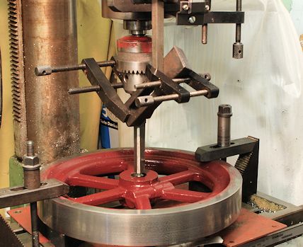

The set up for cutting the internal keyway in the flywheel. All the irongungery is to prevent the chuck from turning whilst operating the z axis to cut the keyway. It took at 20 minutes to cut and and hour to set up !!!!
