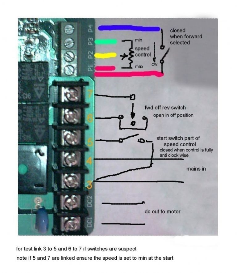

fc250
connections to board
Uploaded by john swift 1 on 18/09/2010 19:03:54
